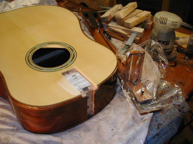

Lance has offered to resize a picture that I sent him. This picture shows the fingerboard with the mahogany fillit and bolt glued to it and some plastic wrap still on the fingerboard extension that I neglected to pull off before taking the picture. (I almost always pull this off before shipping to the customer) And it shows the pocket that I routed in the top for that fillit. It also shows the mortise for the neck tenon and the two bolt holes for the neck bolts. You can see the tenon on the neck. I had to chisel out a little pocket for adjustment rod clearance which was unexpectedly long but I used anyway.
   I hope this makes a little sense, but if not, fire away and I will answer all questions.
   I will add that that mahogany fillit that is now glued to the fingerboard extension was at one time bolted down into that recess that you see in the top just above the sound hole. There are several layers of cardboard that I used to shim that piece of mahogany up to just a hair above the top. That way the mahogany fillit will glue to the bottom of the FBE without a gap. There is a little room at the bottom of the pocket so that there is nothing there to prevent it from clamping down later when the glue hardens. By gluing this down "in place" alligmnent and fitting problems are eliminated. It's like cheating
Let me also add that the next version will have two bolts, side by side, and the adjustment rod and allen screw access will be from inside the guitar body.
John Kinnaird38586.3759722222

John, thanks for the pic! That clears up several questions I had. I do have one more though, are your bolts stuck through the extension block before it is glued to the fretboard, trapping them so they won't spin?

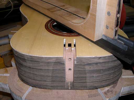

   That L shaped block is at 90 degrees on the inside, but the outside angle is more obtuse and reflects the angle necessary to intersect the bridge. In fact, when I am dressing the top of the sides (and blocks) to accept the top plate, I put a straight edge on the edge of the upper bout, just beside the upper part of the L and rest the other end of that straight edge on a curved brace that goes from side to side at a spot where the bridge will glue. I then shave that upper block L so that the straight edge will lie flat on the block and intersect that arched brace. This has lasting effects as the build proceeds and helps the FBE lie flat on the top and hit the bridge in the right place.

   That bolt is captured with epoxie and will not turn after things are set up.

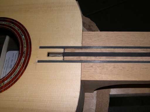

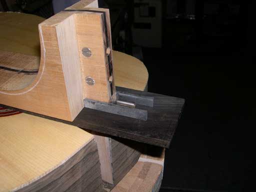

Ok gang here it is:
The two rods come out of the neck (they are all the way up to the scarf) and I actually glue the fingerboard tongue to them.
I cut two little slots for them (by hand with a dovetail saw) that allows them to fit right into the top, they stop just before the tranverse brace. On a florentine one is longer than the other because the tranverse is slanted to accomodate the cutaway.
This is how it fits in, I sand down the upper bout a bit to make it slant just a little towards the top of the guitar, then I set the neck angle and so that the rods sit just proud at the edge and float up a little towards the rosette. That seems to fit my bridge size quite well and has not given me any trouble, and I will tell you this now... I've had the prototype back in the shop a couple of times and when needed I just pop that neck off when working on it, I have 8 of these built this way and NONE of them have given me any problems. The original one had a good size heel block but I'm working on version 2.0 in the downtime from HB and it will be more like what Fox and Russell are doing...
If you have more questions or want more pictures just let me know...

Paul, now you've gone and done it! I love that, so now I'm gonna have to steel that idea as well! Add carbon rods to the mahogany extension I use (I still like the idea of the FB being glued to the same wood all the way down) and not bolt it down at all. Inspired!
Paul, what dimension are the carbon fibre rods you use? Are they the standard Stew Mac ones?

John, are you saying that you use a curved brace the same as your top radius when setting the angle of the neck block extension? My biggest fear in trying the "L" shaped block is that I'll get all the way to fitting the neck and will have screwed something up!

I am using the 1/8 x 3/8 x 18 graphite rods from LMI, I am switching to the longer ones on my new models so I can run them all the way through the scarf (I normally come up just a little shy and fill with ebony).

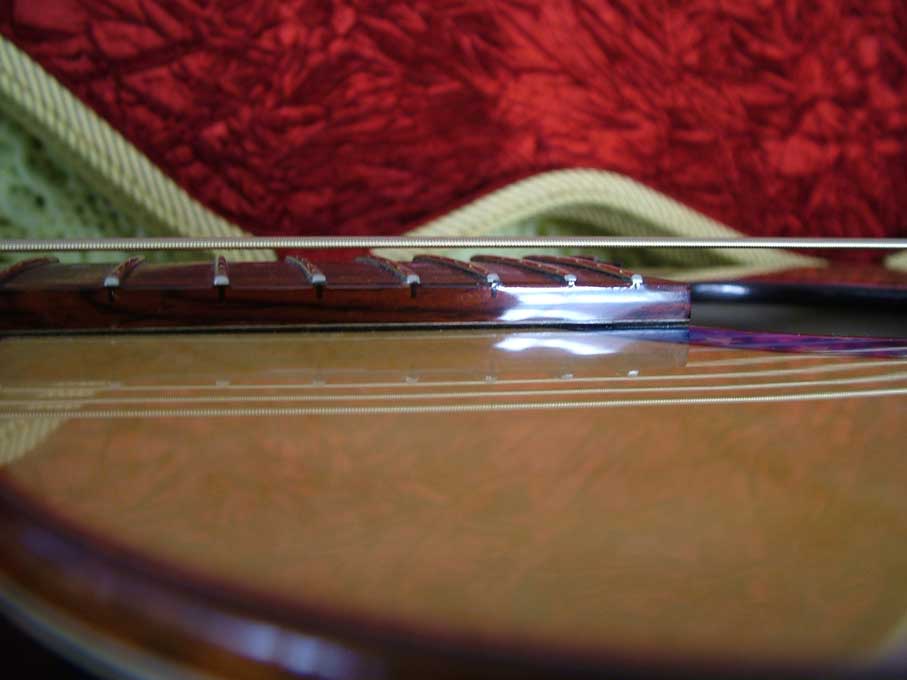

Here is a picture of the tongue on the flag guitar, in the white stage the gap was bigger but the finish took up most of the space, it's about a 64th at the very edge of the soundhole:
I've had the neck off this one 3 times since it was built, there was a run that I sanded out and it sunk back in after I sanded it (I hate that), so I popped off the neck, sanded and polished it out and put the neck back on.
